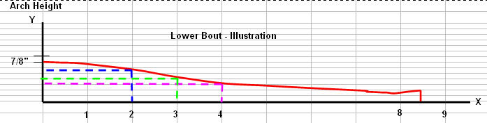

Starting with the Benedetto templates (or your own thoughts on appropriate arch) I draw on graph paper a set of arch profiles for each the upper and lower bouts, waist, centre of the waist to heel end edge and length of the body. Illustration below is for the Lower Bout....
_________________________________

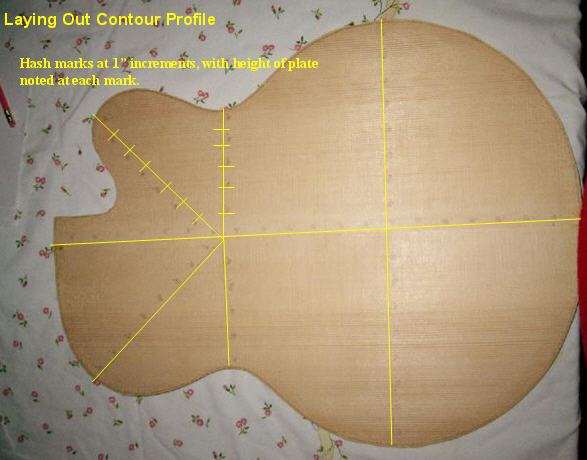

Next I take each of the above described arching templates and plot in one inch increments along the vectors shown in yellow....
________________________________________________

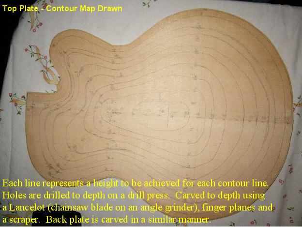

By eye I join each of the marks made plotted on the top from the above picture, creating a "contour map". On each of the lines I mark the height of the arch.
Using your drill press and depth stop, drill 1/4" holes to the prescribed depth on each of the contour maps (sorry I don't have a photo) but the Benedetto book has an illustration to that effect.

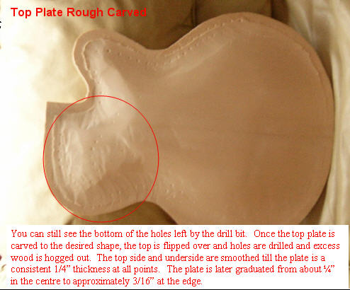

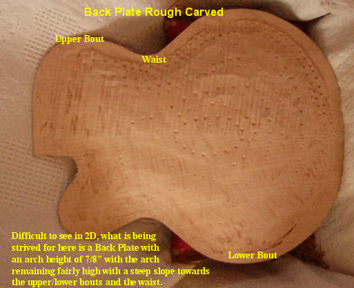

Once done drilling -- I get out the angle grinder fitted with a Lancelot and start hogging away stock till I only see dimples from the drill holes. Finishing up (on maple plates with Angle grinder fitted with 60 drit paper) using finger planes, scraper, orbital sander...etc. Picture below shows a top and back plate after I've put away the Angle grinder/Lancelot.

thank you for posting the tutorial. It will be very beneficial for me. Seeing the photos definately cleared up a few points. One question, My understanding was that the top was 1", you show it to be 7/8th. Or is that the back profile ? I am at work so I can't check the book. Yeh I'm workin hard, why?
PostPosted: Thu Feb 23, 2006 1:48 am
Mike, correct you are if you follow the arching in the Benedetto book, the top plate has an arch of about 1" measured from top to bottom or 13/16" if measured from the apex of the arch to the top of the plate. Like I said you can use the Benedetto arching templates or make your own -- the rough drawing shown in the first picture would be for the back plate.
Mike using the method descriped above together with Paul Woolson's desciption of how to hog out the inside of the plate there is no need to practice anymore. It is really not that hard - time consuming yes. Last thing, I wouldn't get hung up about carving exactly to the profile Benedetto does (mind you its a great guide for your first Archtop). If you decide to deviate make sure the apex of your arch (bridge location)is located longitudinally in the same place as Benedetto advises and that if you go with a shallower arch height that you adjust your neck angle accordingly. You don't want to end up with to high a bridge and huge break angle behind the bridge.
